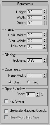

Changes the size of the glazed panel within each sash.
Specifies the number of window panels: one or two. Using two panels creates a window like a double door; each panel is hinged on its outside side edge.
Specifies the percent that the window is open. This control is animatable.
Turn this on to have the sashes open in the opposite direction.
