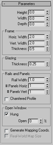

Sets the width of the rails in the sash.
Sets the number of horizontal divisions in each sash.
Sets the number of vertical divisions in each sash.
Chamfers the rails between the glazed panels, as in a conventional wooden window. When Chamfered Profile is off, the rails have a rectangular profile.
When on, the window slides vertically. When off, the window slides horizontally.
Specifies the percent that the window is open. This control is animatable.
