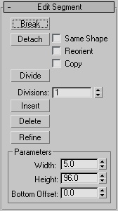

This rollout appears when you select a wall object and then access Segment sub-object level.
Each wall segment is defined by, and effectively connects, two wall vertices. Moving a segment is the same as moving its two vertices in tandem. It has the effect of scaling adjacent wall segments as well as rotating them about their other vertices. You can scale a wall segment horizontally only (any Scale function does this). You cannot rotate a segment.
Specifies a break point in a wall segment.
You needn't select a segment first. When you move the cursor over the object, the mouse icon changes to a Break icon. The position you select on the segment becomes two coincident vertices, and 3ds Max breaks the segment in two.
Detaches wall segments you select and creates a new wall object out of them.
Detaches the wall segment keeping it part of the same wall object. If you also turn on Copy, 3ds Max places a detached copy of the segment in the same location.
Detaches the wall segment, copies the object’s Local coordinate system, and places the segment so that its object Local coordinate system is coincident with the World space origin. If you also turn on Copy, 3ds Max detaches a copy of the segment and leaves the original segments in place.
Copies the detached wall segment rather than moving it.
Subdivides each segment by the number of vertices specified in the Divisions spinner. Select one or more segments, set the Divisions spinner, and then click Divide.
Sets the number by which to divide the segment.
Provides the same function as the Insert button in Vertex sub-object selection. Inserts one or more vertices, creating additional segments. When you move the cursor over the a valid Insert point, the mouse icon changes to an Insert icon. Right click to stop inserting new vertices and segments.
Deletes any selected wall segments in the current wall object.
Provides the same function as the Refine button at the Vertex sub-object level. Adds a vertex to the position along a wall segment you select. When you move the cursor over a valid Refine point, the mouse icon changes to a Refine icon.
Changes the width of a selected segment or segments.
Changes the height of a selected segment or segments.
Sets the distance of the bottom of the selected segment or segments from the floor.
