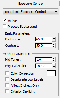

Logarithmic Exposure Control uses brightness, contrast, and whether the scene is outdoors in daylight to map physical values to RGB values. Logarithmic Exposure Control is better for scenes with a high dynamic range.
The controls for the Logarithmic exposure control are the same as for Automatic exposure control, with two additional settings:
Turn on this toggle when the primary lighting for your scene comes from standard lights rather than photometric lights. When you use standard lights and turn on Affect Indirect Only, radiosity and exposure control yield results similar to the default scanline renderer. When you use standard lights but leave Affect Indirect Only off, radiosity and exposure control yield results that can be quite different from the default scanline renderer.
The exterior daylight setting compensates for the extreme intensity of an IES sun light.

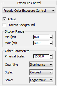

Pseudo Color Exposure Control is actually a lighting analysis tool that provides you with a way to visualize and evaluate the lighting levels in your scene. It maps luminance or illuminance values to pseudo colors that show the brightness of the values being converted.
From darkest to brightest, the rendering shows blue, cyan, green, yellow, orange, and red. (Alternatively, you can choose a grayscale where the brightest values are white and the darkest are black.) The rendering includes the color or grayscale spectrum bar as a legend for the image.
Pseudo color exposure of a scene with radiosity. Areas in red are overlit, areas in blue are underlit, and areas in green have a good lighting level.
This option is useful when the illumination of the surfaces of interest is low compared to the maximum illumination in the scene.

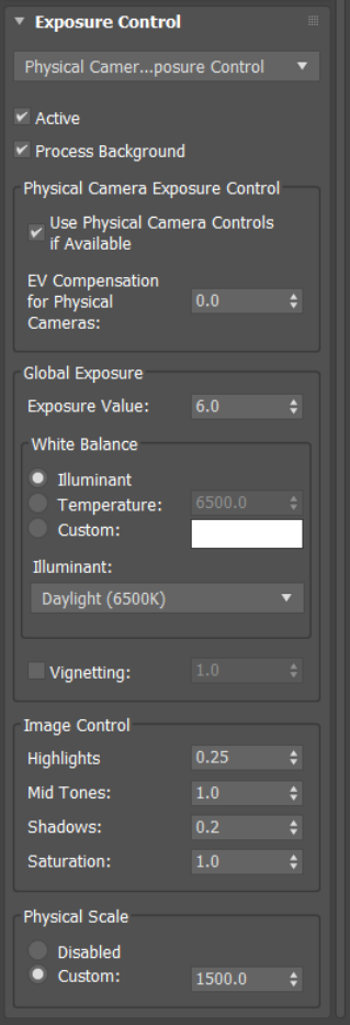

This control sets exposure for Physical Cameras, using an Exposure Value and color-response curve.
This control is a duplicate of the one found under Rendering menu > Environment > Environment and Effects dialog. For more information, see Physical Camera Exposure Control
