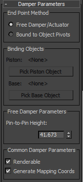

To create a damper:
Choose this when using the damper as a simple object that’s not bound to others or used in a dynamics simulation.
Choose this option when binding the damper to two objects, using the buttons described next.
Use these controls to pick the objects to which the damper is bound. To complete the binding, you must select two binding objects, and then click Bound to Object Pivots.
Displays the name of the object bound to the piston of the damper.
Click this button and then select the object to be bound to the piston of the damper.
Displays the name of the object bound to the base of the damper.
Click this button and then select the object to be bound to the base of the damper.
Use this field/spinner to specify the distance between the bottom center of the base and the top center of the piston when the damper is not bound.
When on, the object appears in the rendering; when off, the object does not appear.

Sets up the required coordinates for applying mapped materials to the object. Default=on.
