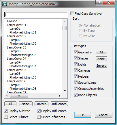

If normal attempts to open a scene fail, another thing you can try is merging the scene. If the file is not too corrupted, you would be able to access the Merge dialog which shows a list of the components in the scene. This is a good sign because, with a little effort, you can fix the file yourself. You now need to narrow down which object, or objects, are causing the load failure.
  1. Start 3ds Max.
  2. Choose File menu Import Merge.
  3. Browse to the folder containing the model, select the model and click the Open button.
    The Merge dialog is displayed, showing all the components in the scene.
    You'll start by seeing if any of the objects or shapes in the scene are corrupt.
  4. In the List Types group, on the right, turn off everything except Geometry, Shapes, and Groups/Assemblies.
  5. Click the All button at the lower left, and then click OK.
    If the objects appear in the viewports, you know the scene components are fine and you'll have to repeat these steps with other List Types turned on.
If the objects merge successfully, and you have to try merging in other objects, be sure to first save what you've just merged as a basis for rebuilding the scene.
    If you receive an error message, you know one of the objects is the offending item. Then, do as follows.

  2. Once again, choose File Merge and turn off everything except Geometry, Shapes, and Groups/Assemblies.
  3. Select the first 10 objects in the list of components and click OK.
    If those objects merge successfully, save the scene and repeat the Merge operation with the next set of 10 objects. Eventually, one of the sets of objects you try to merge will report the error message.
  4. Keep refining the number of objects you are merging until you have singled out the object that reports the error.
  5. Once you've found the corrupt object, reset 3ds Max and merge all the objects and components except for the object you've singled out.
  6. After everything is merged, save the scene and rebuild the object that was corrupt.
