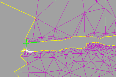

  3. Click on a boundary to select the first endpoint for the bridge.
  4. Click on the opposite boundary to select the second endpoint for the bridge.
    Locators indicate the location of the endpoints. The edges that will be used in the bridge are highlighted.
  5. Select the locators and move them along the boundaries to fine tune the position of the endpoints.

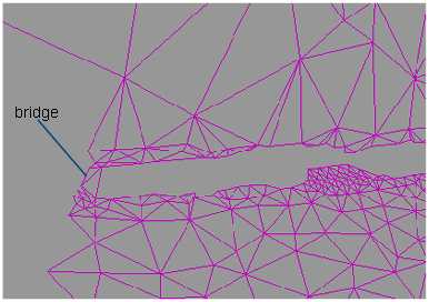

  6. Click Go.
    A “bridge” made up of two triangles is built between the endpoints.
  7. Use Edit > Undo to undo the bridge and start again if necessary.
    Note:
    If you also build a bridge at the other end of the gap, you produce a hole which can then be filled with Mesh > Mesh Cleanup > Mesh Hole Fill.
