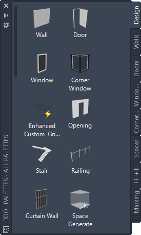

Tool palette containing a curtain wall tool
The following palettes contain one or more curtain wall tools:
Tool Palette Curtain Wall Tools
Design palette in the Design palette group a tool for the Standard curtain wall style and default settings for other curtain wall properties
Design Tool Catalog in Content Browser a package of curtain wall and curtain wall unit tools.
custom tool palettes created by your CAD manager tools with curtain wall styles and properties that your CAD manager customized for your projects or office standards.
