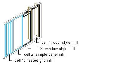

Curtain walls are made up of one or more grids. Each grid in a curtain wall has either a horizontal division or a vertical division, but you can nest the grids to create a variety of patterns from simple to complex.
Curtain wall nested grid example
Each cell in a grid can contain either a panel infill, to represent basic cladding materials such as a stone wall panel or glazing, or an object such as a window or a door.
Assigned curtain wall infill types

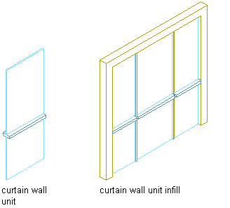

Curtain Wall Units and Door/Window Assemblies
Other objects you can insert in a grid include curtain wall units and door/window assemblies. Curtain wall units are designed to represent complex elements that are repeated within your main curtain wall.
Assigned curtain wall unit infill

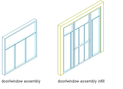

Window assemblies serve a similar function as curtain wall units but can contain panel infills or objects such as doors or windows. Door/window assemblies can be inserted into curtain walls and standard walls.
Assigned door/window assembly infill
Both curtain wall units and door/window assemblies can reduce the need for nested grids, making edits to the curtain wall easier.

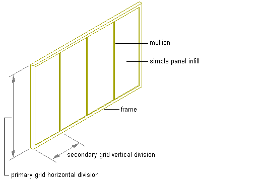

Elements of Grids
Grids are the foundation of curtain walls, curtain wall units, and door/window assemblies. Every grid has four element types:
Note: Division is an abstract element, in contrast to the other three element types that represent physical elements of the curtain wall.
Each element type is assigned a default definition that describes what elements of that type look like.
Element type Default definitions
Divisions Primary horizontal grid with a fixed cell dimension of 13' and secondary vertical grid with a fixed cell dimension of 3'
Cell Infills Cells containing simple panels 2" thick
Frames Left, right, top, and bottom outer edges of grid 3" wide and 3" deep
Mullions Edges between cells 1" wide and 3" deep

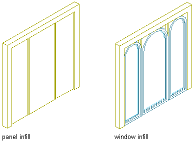

You can create new element definitions and assign those definitions within the curtain wall. For example, you can create multiple infill definitions, and then assign different infills to specific cells in the grid.
Assigning different infills to curtain wall cells

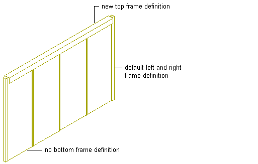

Likewise, you can create multiple frame definitions and then assign a different definition to each frame edge (top, bottom, left, or right). You can also create multiple mullion definitions.
Specifying different frame definitions for each edge of a frame
