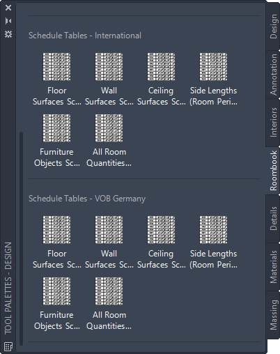

Schedule Table Commands
The tool palette Roombook contains the different schedule tables depending on the current calculation standard. The commands are linked to the file
Roombook Styles.dwg.
