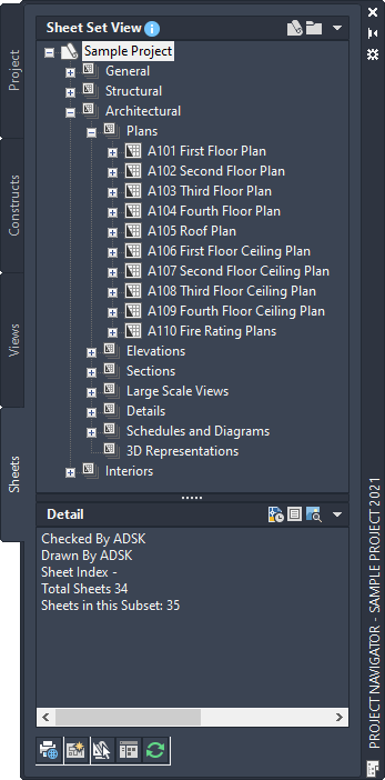

When you create a new project, a unique sheet set is created for this project. The project sheet set is displayed on the Sheets tab of the Project Navigator.
Project sheet set in AutoCAD Architecture 2021 Toolset Project Navigator
