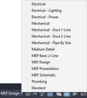

To change the current display configuration
The displays included with the drawing are listed.
Default display configurations included in the Aecb Model drawing template
