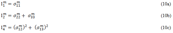

In Eq. 9, the quantities ij sup m (j = 1, 2, 4) are transversely isotropic invariants of the matrix average stress state.
eq 10
The quantities ai supm (i = 1, 2, 4) are the adjustable coefficients of the matrix failure criteria that must be determined from tensile tests for the 0, 90, and 45 degree data sets. If you don't have stress-strain data at 45 degrees, we use the 90 degree curve and raise the stress data points by 5%. Refer to the Material Characterization topic for more details on how the failure coefficients are determined.
