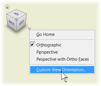

Right-click the View Cube, and click Custom View Orientation to enter the Custom View environment. Then specify the orientation of the custom view.

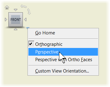

By default, Orthographic projection is used to create drawing views. To use Perspective projection, when you create a base view or edit a base view or independent projected view, right-click the view cube, and click Perspective.

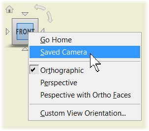

For drawing views based on a presentation view of the model, you can access and apply camera settings saved in the presentation file (.ipn). Right-click the View Cube, and click Saved Camera.
Model orientation in the drawing view changes to match orientation saved in the presentation view.

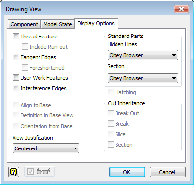

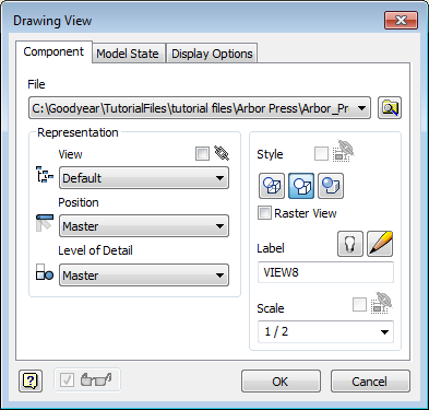

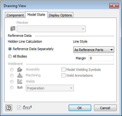

The Drawing View dialog box is streamlined to support new workflows with direct interaction in the graphic window.
Size of the dialog box is reduced:
Some dialog box options are moved, changed, or removed:
Component tab
Display Options tab
Presentations frame.
Model State tab

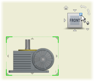

Use the View Cube to specify new orientation and type of projection for the view. Drag a view corner to change the scale.
