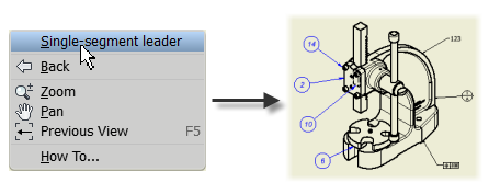

Select the Single Segment Leader option to change the default procedure and create drawing annotations with a single leader segment. The Single-Segment Leader option is available for balloons, leader text, surface texture symbols, welding symbols, feature control frames, datum targets, and sketch symbols. You set the option separately for each type of drawing annotations.
Drawing annotations with leaders can now be aligned in one step. In the drawing, select the annotations to align. Right-click, and on the menu, click Align
Vertical, Horizontal, or To Edge.
Any window selection that includes annotations supported in the Align commands is valid, and displays Align commands in the right-click menu. After you start an alignment command, all objects that cannot be aligned are automatically removed from the selection set.
The default behavior and CTRL-key behavior for placing drawing annotations are switched. Hold CTRL key to enable 15° leader snapping.
