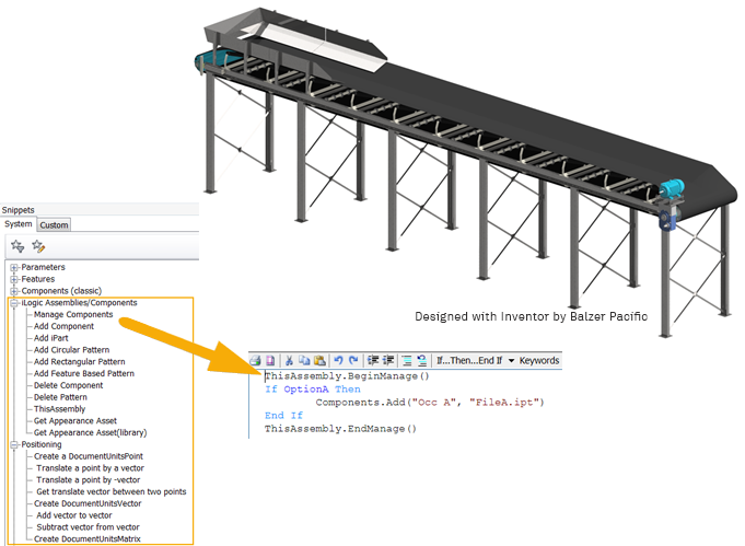

iLogic improvements make it easier to create rule code for adding, modifying, and deleting components and constraints.
Document Units Geometry
There are new functions that use document units for coordinate values and objects representing points, vectors, and matrices.

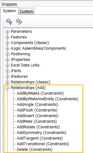

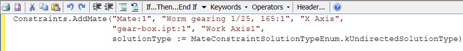

New iLogic Assembly Add Constraints Functions
The new iLogic Relationships (Add) functions allow you to create an iLogic assembly whose occurrences and constraints are generated by a rule.

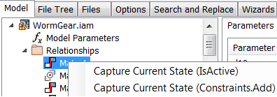

New Capture Current State Commands
The Capture Current State command now retains states when you use: Components.Add, Components Constraints.Add, Constraints.Add, and Patterns.Add.

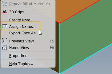

Constrain Geometry by Assigned Names
You can now assign names to faces and edges, and then create a rule that adds the constraint(s) directly to a face or edge with those names.

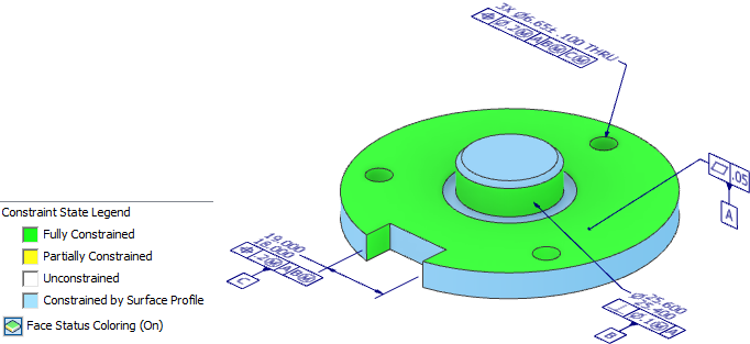

The Tolerance Advisor now displays constraint state using a color code. Click Face Status Coloring in the Tolerance Advisor to turn on the display of colors.
For details, see Model-Based Definition Enhancements

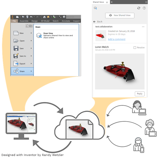

Shared Views provide a better way for designers, engineers, and visual artists to get feedback on their work in progress, simplifying and speeding up review cycles. Use Shared Views to share 2D or 3D views of your work online and see comments directly in the product you're working in. With shared views, any reviewer can review and comment online via the Autodesk Viewer. They avoid the need for stakeholders to install a specific viewer and provide powerful commenting and markup tools for conveying detailed feedback. Because shared views are visual representations that expire after 30 days, your native designs or models are always protected. This gives their authors a way of clearly separating unfinished work being shared for feedback purposes from more formal and permanent deliverables.
For details, see Collaborate on 2D and 3D Views with Anyone Using Shared Views

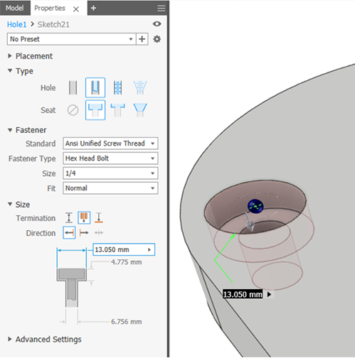

The new Hole command is faster and smarter by inferring hole placement from your interactions. You can apply dimensional and concentric constraints without first creating a sketch. Then, switch between feature editing and sketch editing without exiting the command.
For details, see Hole Feature Productivity, Workflow, and UI Enhancements

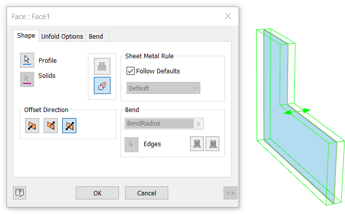

Symmetric Face
Many have asked to be able to center the sheet metal part along its thickness. We heard you, and the Face command now supports extruding from the mid-plane to create a symmetric face.

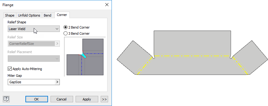

Laser Weld Relief Shape
The Linear Weld corner relief terminates on a point, the Arc Weld corner relief shape terminates with a straight line segment. The new Laser Weld corner relief terminates with a tangent arc and is more suitable for laser cut parts.
For details, see Sheet Metal Enhancements

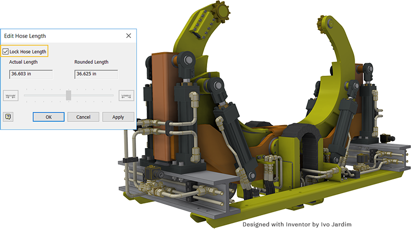

Lock Hose Length
The new option, Lock Hose Length, allows you to calculate an exact sum of hose length. When selected, if components move or shift, this option prevents the length of the hose from changing due to adaptivity.
You can also lock hose length by adding a General Dimension
from the 3D Sketch tab
Constraints panel to a flexible hose in the graphics window.
For more details, see Tube and Pipe Enhancements

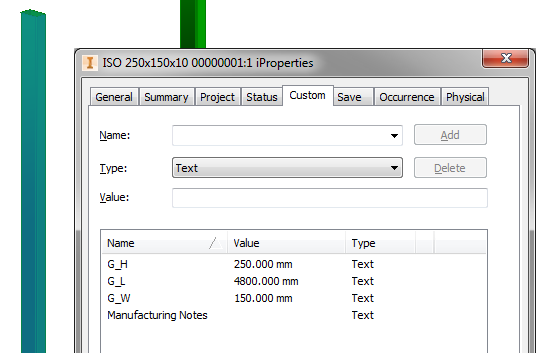

CUTDETAIL Enhancement
The values generated by applying the Trim/Extend command to cut angles on frame members are available in the iProperties/Custom tab as CUTDETAIL1, CUTDETAIL2, etc. These can be included in the Bill of Materials and Parts List. Additionally, the Frame Generator G_L parameter reports the correct lengths.
For details, see General Enhancements in Assembly

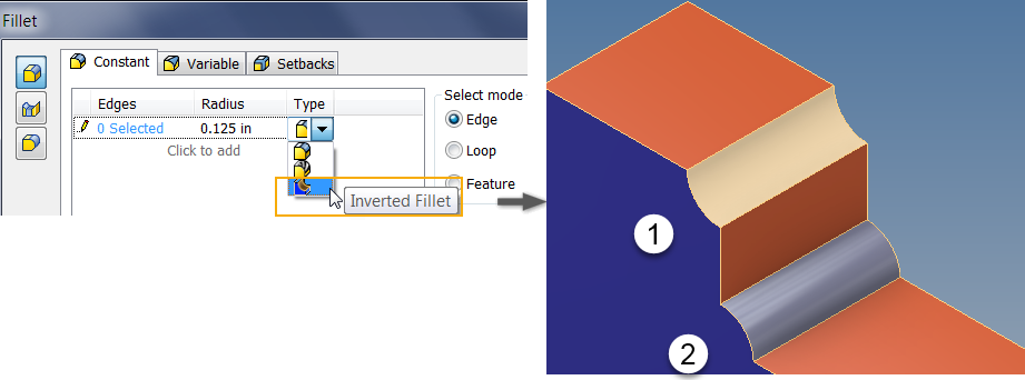

This new fillet option is the result of your feedback. You can create a fillet with 1) convex edges or 2) concave edges.
For details, see General Enhancements in Parts

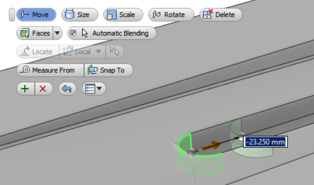

Previously with 3D Model tab
Modify panel
Direct Edit, you could only rotate or move a face feature to another location. When deselected, Automatic Blending maintains this behavior and moves a face to a new location. When selected, the total length of a face feature is modified.
Automatic blending is a re-blending technology that automatically moves adjacent tangential faces and also creates new blends if required. It is available when you move or rotate a face.
For details, see Direct Edit Enhancements

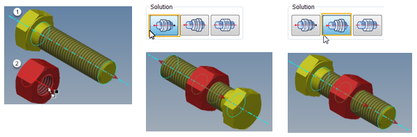

New Solutions for Constraining 2 Axes
Aligned: Maintains the mate direction of the first selected component.

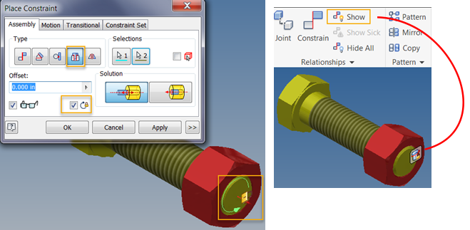

New Option to Lock Rotation with Insert Constraint
Use the new option, Lock Rotation, to lock the rotational degrees of freedom on a component when placing an insert constraint. This option prevents the part from rotating.
With Lock Rotation applied, the Insert constraint displays with a locked icon in the browser.

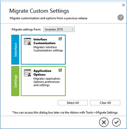

Use Migrate Custom Settings to bring your existing customization and Application Option settings into the latest Inventor Release. Administrators have additional control over use of this option in deployments.
For details, see Other General Enhancements

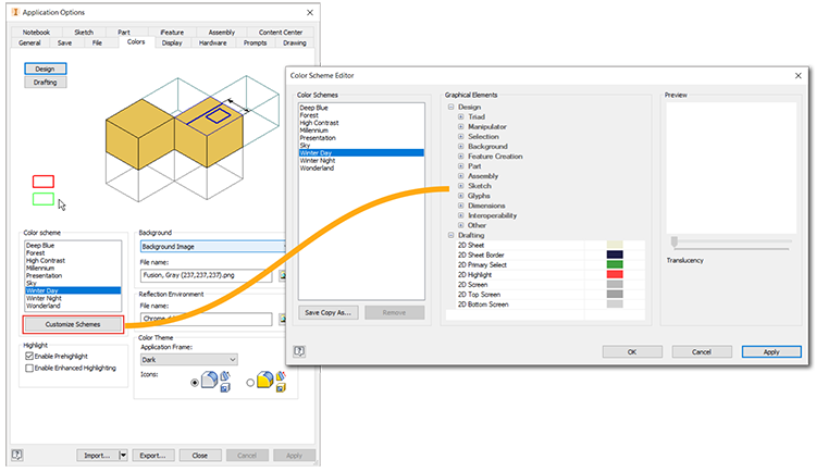

The color scheme editor is installed as part of Inventor 2019. You can access it from the Application Options > Color Tab. Customizations are saved to the Application Options xml file.
For details, see Color Scheme Enhancement
