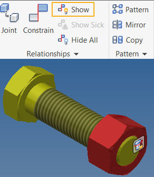

Use the new option, Lock Rotation, to lock the rotational degrees of freedom on a component when placing an insert constraint. This option prevents the part from rotating.
| A lock icon displays in the graphics window when placing an Insert constraint with Lock Rotation selected. By default, the lock icon no longer displays after closing the Place Constraint dialog box. | To view the lock icon in the graphics window after closing the dialog box, click Assemble Relationships panel
Show. Once displayed, you can right-click the icon, and access options for suppressing, and other edit operations.
Once Lock Rotation applied, the Insert constraint displays with a locked icon in the browser.
For more information, see To Place Insert Constraints in Assemblies.
