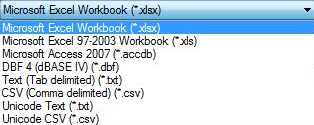

A new list of acceptable formats to export your Global BOM, parts lists, and revision tables is now available in the drop-down menu.
The Access, DBF, Text, CSV, and Unicode exports require Microsoft Access Database Engine to be installed on your computer, which is part of Microsoft Office installation. For 64-bit Inventor, install 64-bit Microsoft Office in order to export these files. If 64-bit Microsoft Office is not installed, the following error message displays:

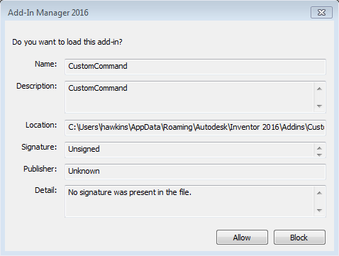

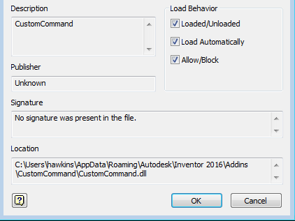

When a non-Autodesk product add-in is loaded, a new dialog box displays. You can now choose to Allow or Block an add-in from loading. This setting will be retained for future sessions. You can examine and change the Allow/Block settings using the Add-In Manager.
The following three security controls are now available in the Add-In Manager 2016 dialog box:

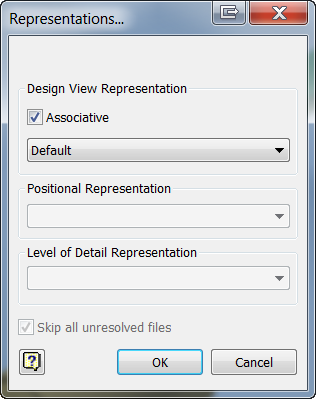

Use the new Representations dialog box to change the current design view and associativity. To access this new dialog box, right-click the Explosion node within your model browser in a Presentation and select Representations.

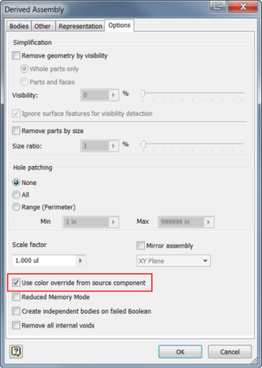

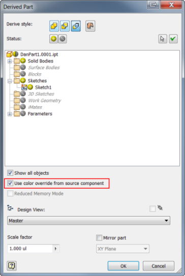

A new Use color override from source component option is available in Derived Assembly, Derived Part, Make Part, and Make Component dialog boxes. This checkbox, when checked, pushes the Part appearance and body, feature, or face color overrides applied to faces from the derived part into the new part. If unchecked, the appearance is set to default.
Example dialog boxes:

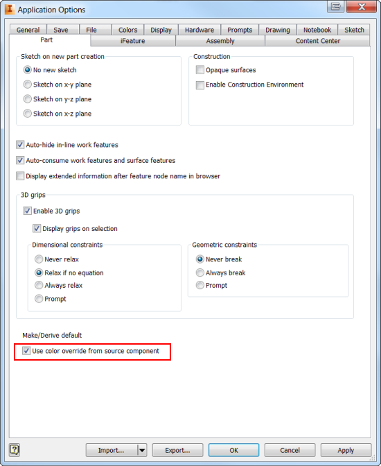

A global setting can be set to default the Use color override from source component check box to remain checked or unchecked throughout your session. This check box can be accessed through the Application Options dialog box under Make/Derive default, under the Tools tab in the ribbon.

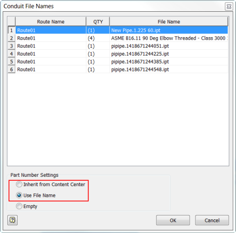

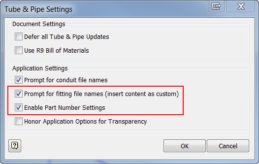

You can now customize file names for fittings and populate part numbers into your parts list within the drawing environment. Previously, you could only change the name of your conduit items, but now you can update fittings as well.
Updates to dialog box options within the Tube and Pipe environment:
Prompt for fitting file names (insert content as custom): By selecting this option, you are able to customize the name of your fittings within the Conduit File Names dialog box.
Enable Part Number Settings: Allows you to populate a part number into the parts list within the drawing environment. The part number is updated within the part file and then populates the parts list. This option also makes available the Part Number Settings options in the Conduit File Names dialog box.
Part Number Settings: The Part Number Settings field is made available by selecting the Enable Part Number Settings check box in the Tube and Pipe Settings dialog box. New options within this dialog box are:
