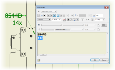

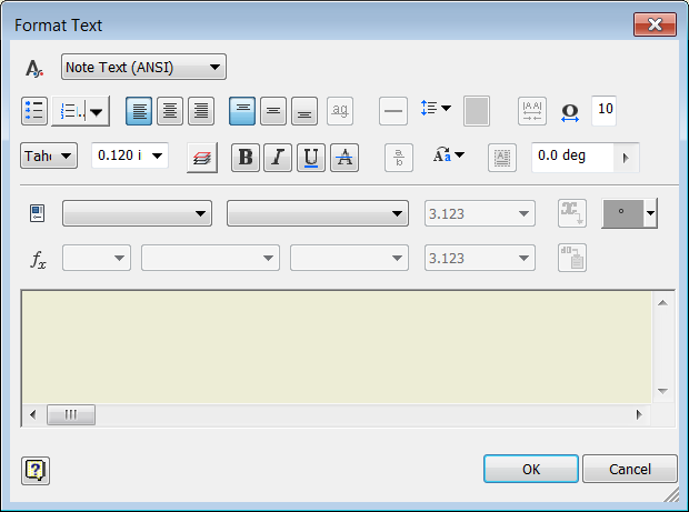

The Format Text dialog box is simplified and refined to be clear and easy to use. Size of the dialog box is reduced to provide more space for editing in the graphic window.
You can create bulleted or numbered lists in the Format Text dialog box. One bulleting style and several numbering styles are available.
In the Format Text dialog box, select a string, and select a Text Case option to convert the string to UPPERCASE, lowercase, or Title Case.
In the Format Text dialog box, click the Strikethrough button to apply strikethrough formatting for a string.

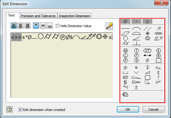

New graphical symbols are added in the Symbols list in the Format Text dialog box.
The symbol drop-down list has been removed and replaced by the graphic symbols as first-level options.
Text in a drawing file is dynamically previewed in the graphic window when you create or edit it. You can refine the appearance of text before you close the Format Text dialog box.
The Zoom In and Zoom Out buttons are removed from the Format Text dialog box. To zoom the edited text, place the cursor in the editing field, hold the CTRL key on your keyboard, and scroll the mouse wheel.
Select a text object, and drag the blue rotation grip point to rotate text to the desired position.
In the Format Text dialog box, use the Rotation Angle option to rotate leader text in a specified angle.
