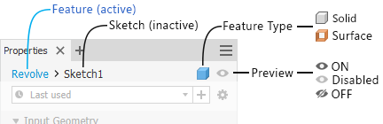

At the top of the property panel is the breadcrumb. You begin with feature definition but can quickly move between feature definition and editing the sketch by clicking the breadcrumb sketch text. Return to the feature environment by clicking the breadcrumb feature text.
- To the right of the breadcrumb is the feature type. The type determines which options are presented in the property panel.
Specify the feature type:
Solid (default) - Creates a solid feature from an open or closed profile. Open profile selection is not available for base features.
Surface - Creates a surface feature from an open or closed profile. The feature functions as a construction surface on which to terminate other features, or a split tool to create a split part, or split a part into multiple bodies. Surface selection is not available for assembly revolves or primitives.
Click the icon to switch to the other feature type.

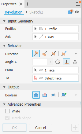

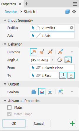

- Specify the Input Geometry. You can use window select to quickly select multiple closed profiles within the same sketch.
Important: During feature preview visible sketch dimensions can be edited without entering the sketch environment.
- Profiles - the Profiles selector is active by default and when there are:
Note: For part features, you can use a shared sketch as a profile. To share a sketch:
- In the browser, click the plus sign beside the feature that contains the sketch you want to use to expose the sketch node.
- Right-click the sketch icon and click Share Sketch. Any sketch that you use in more than one feature is automatically shared.
- Axis - right-click in the display and select
Continue or click the property panel selector and then select an axis from the active sketch.
- Specify the
Behavior parameters.
- Direction
Default: Revolves in one direction only.
Flipped: Revolves in the direction opposite of Direction (default).
Symmetric: Revolves in opposite directions from the sketch plane, using half the specified Angle A value in each direction.
Asymmetric: Revolves in opposite directions from the sketch plane using two values, Angle A and Angle B. Enter a value for each angle. Click
Flip to swap the angle values.
- Angle
- For multi-body parts, click the From Selector and select the participating body.
- For non-base features, specify an operation:
Join: Adds the volume created by the revolved feature to another feature or body. Not available in the assembly environment (not available in Inventor LT).
Cut: Removes the volume created by the revolved feature from another feature or body.
Intersect: Creates a feature from the shared volume of the revolved feature and another feature. Deletes material that is not included in the shared volume. Not available in the assembly environment (not available in Inventor LT).
New Solid: Creates a solid body. Each solid body is an independent collection of features separate from other bodies.
- Advanced Properties
- iMate (Optional) Places an iMate on a full circular edge. Autodesk Inventor attempts to place the iMate on the closed loop most likely to be useful. In most cases, place only one or two iMates per part.
- Match Shape: If you select an open profile in a part file, specify whether you want to Match Shape and, if so, select the side to keep.
Selecting Match Shape creates a flood-fill revolved feature. The open ends of the profile are extended to the axis of revolution (if possible), or to the bounding box of the body. The Match Shape revolution generates a stable and predictable body for topology changes on the defining faces.
Clear the Match Shape option to close the open profile by extending the open ends to the part, and closing the gap between them. The revolution is created as if you specified the closed profile.
- Click
OK or
(Create new feature) to continue defining revolved features.
