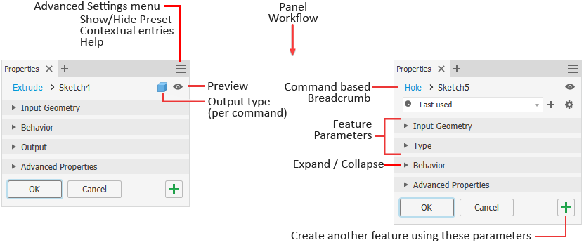

The property panel floats above the graphic area and, initially, appears in the upper left of the graphics area. Panels can be resized, combined with the Model browser, moved to another location, and even to a secondary monitor. Property Panels use expandable sections instead of tabs.
Key Concepts
  • Workflow - the property panel workflow is from top to bottom. Any property you set or change can affect the properties in sections below it. A property does not affect the properties in preceding sections.
  • Breadcrumb - quickly switch from editing the feature to editing the associated sketch. Rename the feature or sketch right from the breadcrumb.
  • Preview - located to the right of the breadcrumb, Preview toggles the feature preview visibility when editing the feature or sketch. During sketch editing, selected regions or loops preview in wireframe. Toggle the option to hide the preview.
  • Presets - use presets to create reusable feature definitions. For more on Presets, see To Work with Presets.
  • Value edits - use Enter to apply value edits. Use Tab to progressively move to the next field. Press CTRL+Enter to end the definition and create the feature and close the property panel. When a value is invalid the value color turns red. When a value is valid the value color is black. Edit fields cross-highlight between the property panel and the in-canvas edit controls. This default behavior can be overridden by using the Advanced Settings option Single ENTER to finish command.
  • Expand/Collapse - panel sections can be expanded to expose parameters for editing or collapsed to hide seldom used parameters.
  • Advanced Settings menu - the drop down provides access to Show/Hide Preset, Help and other advanced settings. The menu adjusts based on context. For example, when creating or editing a feature, the menu list contains options related only to the feature being edited. When working in the browser, the panel menu is according to the model browser state, and so on.
  • Apply and create new - click to create the feature using the current settings and begin creating another feature using the same settings. You can change any settings, as needed, then create another feature.
  • Docking - the property panel can be docked in any Inventor application graphics window, within the browser space, or remain floating whether over the application or somewhere on the desktop. This allows you to position the panel or browser wherever it is convenient for you. When docking the panel to a window frame, the target frame edge highlights.
  • Display - panels remember their most recent display state and use that when next visited.

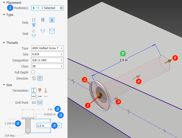

Property Panel and In-canvas Editing
When creating or editing features you can use the edit fields in the Property panel, the in-canvas edit fields, or the feature manipulators to modify values.
The following example uses the Hole feature to illustrate the various parameter value access points.
The default behavior for the property panel and in-canvas edit controls allows you to use keyboard entry. When editing a value input the following applies:
  • When the property panel has focus or a value in an edit control is highlighted, Enter completes the feature definition the same as clicking OK, and closes the property panel.
  • When a value edit control has focus and you are actively modifying a value, the Enter key affects only the value.
  • When a selector field is unfulfilled and there is no active HUD control, ENTER acts like Continue, and moves the focus to the unfulfilled field. To deactivate a HUD control, click in a blank area of the display.
  • When a value edit control has focus you can complete the feature definition process and close the property panel by using CTRL+Enter. You can also use ENTER twice to achieve the same result.
  • When using the context menu of a value edit control, after adding the value selection, the cursor moves to the end of the control, clearing the selection. This aids with making use of feature dimensions and applying factors to those values.
The legacy ENTER behavior can be recovered as mentioned above in Advanced Settings Menu section.

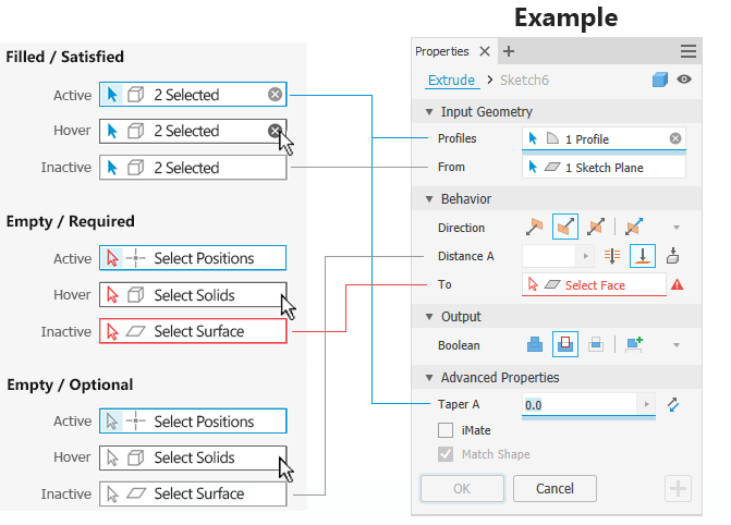

Selector States
The property panel selectors display their states using colors. The following image shows the states and ties them to an example.
Clearing Selections
When a selection is made, the selector field displays the number of items selected and an 'X' at the right end of the field. To clear the selection set, click the 'X', then, make your next selections.
