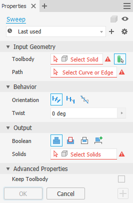

Important: The Sweep command uses a property panel to define the feature. If you are not familiar with Inventor property panels, see
About Property Panels to learn about the workflow, behaviors, and advanced options, such as the panel menu and advanced settings. Keep in mind the selections you make in a section, determine the options presented in the next section, as you work from top to bottom in the property panel.

- Before you start the command:
- Create the base solid.
- Create the sweep path.
- Create the solid toolbody, preferably at the start of the sweep path.
- Click
3D Model tab
Create panel
Sweep
If required, enable the Solid Sweep option
- Select the solid Toolbody.
- Select a Curve or an Edge to define the Path.
- Choose an Orientation:
Follow Path
Fixed
Aligned
- If using the Aligned option, select the axial direction Vector.
- If required, specify the Twist angle. The Twist angle is related to the toolbody, not 3D space.
If required, select the Twist Axis.
The following image shows the effect of a 90 degree Twist angle in an Aligned sweep. The twist angle applied to the toolbody creates a design that can rotate a bottle from horizontal to vertical along the path.
(Model credit:
Scott Moyse)
- Specify an Output operation:
- Join
. Adds the volume created by the swept feature to another feature or body. Not available in the assembly environment.
- Cut
. Removes the volume created by the swept feature from another feature or body.
- Intersect
. Creates a feature from the shared volume of the swept feature and another feature. Deletes material that is not included in the shared volume. Not available in the assembly environment (not available in Inventor LT).
- New Solid
. Creates a solid body. Each solid body is an independent collection of features separate from other bodies. A body can share features with other bodies.
- Click Ok.
