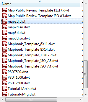

Create a map file using a standard template. Assign a coordinate system. Any data you add to your map is converted to that coordinate system.

Drawing.
Select map2d.dwt
This file is an AutoCAD template that is set up to work with two-dimensional maps in AutoCAD Map 3D toolset.
