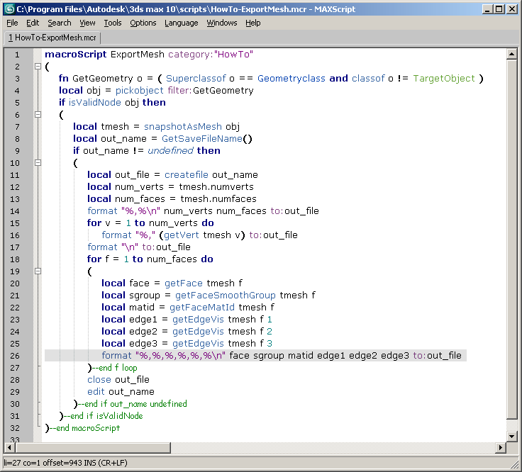

MAXScript opens the selected script in a tab inside the modeless MAXScript Editor window:
The MAXScript Editor is suited for developing longer scripts or code fragments you want to keep. You can edit and test parts of them until they are complete, then save your code in a script file for later use. This is a common method for developing large scripts, utilities, and function libraries.
