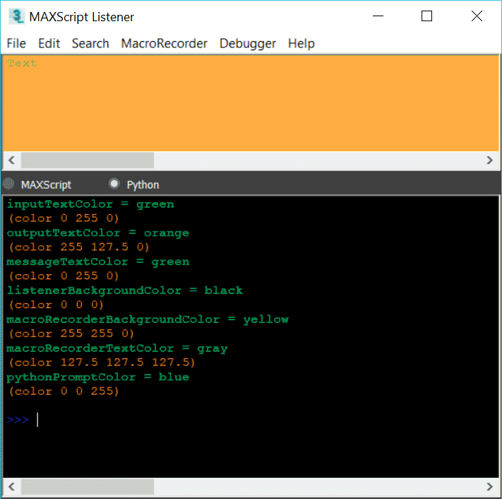

inputTextColorLets you get and set a Color value defining the color of typed input text in the MAXScript Listener.
messageTextColorLets you get and set a Color value defining the color of error message text in the MAXScript Listener.
listenerBackgroundColorGets or sets the background color of the MAXScript Listener. When this value is changed, the caret color changes between black and white as necessary to remain visible. Available in 3ds Max 2020 and higher.
macroRecorderBackgroundColorGets or sets the background color of the macro recorder pane. When this value is changed, the caret color changes between black and white as necessary to remain visible. Available in 3ds Max 2020 and higher.
macroRecorderTextColorGets or sets the color of text in the macro recorder pane. Available in 3ds Max 2020 and higher.
pythonPromptColorGets or sets the color of the prompt in the MAXScript Listener when it is in Python language mode. Available in 3ds Max 2020 and higher.
macroRecorderSelectionForegroundColorGets or sets an override color value for selected text in the macro recorder. A value of 'undefined' means the default setting is used. Available in 3ds Max 2020.1 Update and higher.
macroRecorderSelectionBackgroundColorGets or sets an override background color value for selected text in the macro record. A value of 'undefined' means the default setting is used. Available in 3ds Max 2020.1 Update and higher.
macroRecorderSelectionAlphaGets or sets an override alpha channel (translucency) for selected text (foreground and background) in the macro recorder. This value is in the range of 0 to 255. A value of 'undefined' means the default setting is used. Available in 3ds Max 2020.1 Update and higher.
listenerSelectionForegroundColor Gets or sets an override color value for selected text in the MAXScript listener window. A value of 'undefined' means the default setting is used. Available in 3ds Max 2020.1 Update and higher.
listenerSelectionBackgroundColor Gets or sets an override background color value for selected text in the MAXScript listener window. A value of 'undefined' means the default setting is used. Available in 3ds Max 2020.1 Update and higher.
listenerSelectionAlpha Gets or sets an override alpha channel (translucency) for selected text (foreground and background) in the MAXScript listener window. This value is in the range of 0 to 255. A value of 'undefined' means the default setting is used. Available in 3ds Max 2020.1 Update and higher.
outputTextColorLets you get and set a Color value defining the color of output text in the MAXScript Listener.
