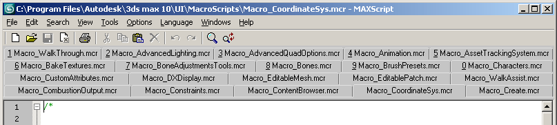

tabbar.multiline (MAXScript default: not set)Setting tabbar.multiline uses multiple lines for the tab bar, thus fitting more tabs on screen at the same time.
