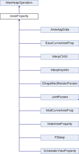

+ Inheritance diagram for AnimProperty:

Implemented in IShapeRectRenderParams, MultCurveAnimProp, EaseCurveAnimProp, JointParams, InterpKeyInfo, InterpCtrlUI, NoteAnimProperty, AnimAppData, and SchematicViewProperty.
