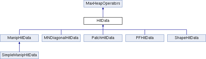

 Inheritance diagram for HitData:
 Inheritance diagram for HitData:| Public Member Functions | |
