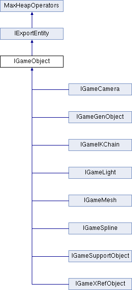

 Inheritance diagram for IGameObject:
 Inheritance diagram for IGameObject:| Public Types | |
