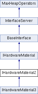

Extension of IHardwareMaterial Interface.
This class extends the functionality of IHardwareMaterial. To acquire this interface, simply call GetInterface(IHARDWARE_MATERIAL2_INTERFACE_ID). If failed, it will return NULL.
