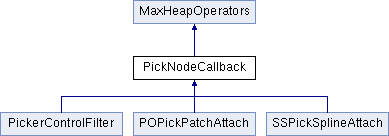

This class is used to filter nodes during a hit test. See the methods Interface::PickNode(). and PickModeCallback::GetFilter().
+ Inheritance diagram for PickNodeCallback:

Implemented in SSPickSplineAttach, PickerControlFilter, and POPickPatchAttach.
