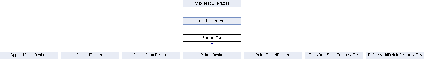

This class is the restore object used in the undo / redo system of 3ds Max.
+ Inheritance diagram for RestoreObj:
