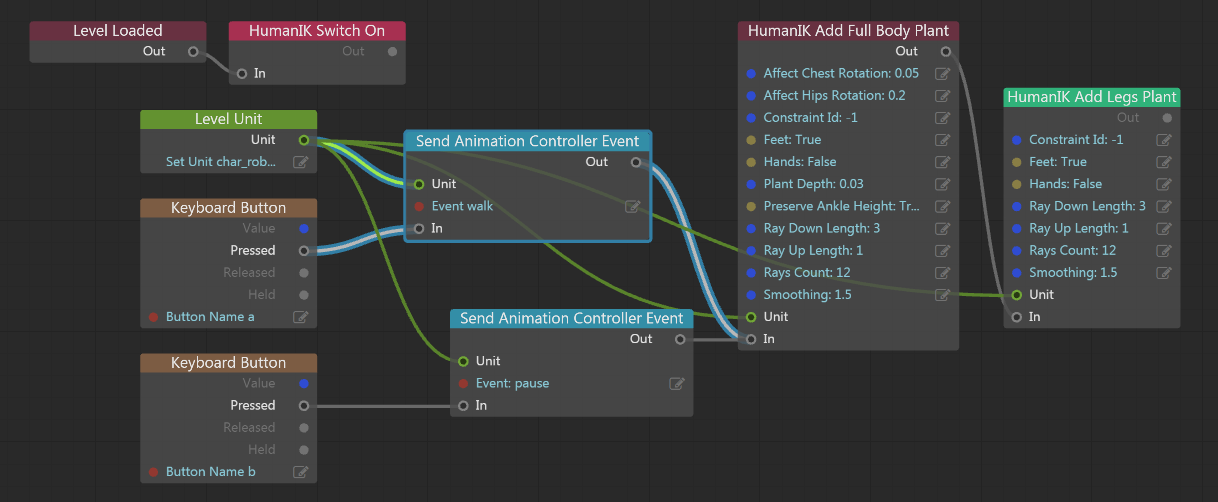

Enable HumanIK (disabled by default).
You can control HumanIK using HumanIK flow nodes. Both level flow graphs and unit flow graphs are supported.
You can enable HumanIK in the level flow graph, when the Event > Level Loaded event gets triggered.
Equip your character with all constraints it might use during its lifetime - in this case, the floor contact related constraints (the Full Body Plant and the Legs Plant constraints).
This part is usually done in the unit flow graph, when the Unit > Unit Spawned event gets triggered.
Alternatively, you can enable and set up HumanIK through LUA.
Set up these flow nodes and test your level:
Add Input controller node and set Animation > Send Animation Controller Event to trigger the motion clips for the character using the input controller while level testing.
Tip: At any point, you can smoothly enable/disable the floor contact constraints by setting their “Blend Alpha” values to 1/0. This can be done using the HumanIK > Character Tune Constraints > HumanIK Set Blend Alpha flow node. Disabling the constraint and re-enabling it might be useful when dealing with jumps, for instance.
Add HumanIK flow nodes to test and tune IK constraints and retarget your characters and set a look at constraints.
