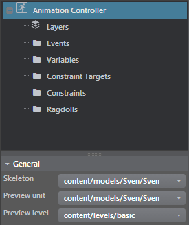

Double-click the Animation Controller to open the Anim Controller Editor.
In the General properties, notice that the Skeleton drop-down is automatically set to display the skeleton you selected, and the character unit is selected as the Preview unit.
These properties define global options for the animation controller (and the preview window).

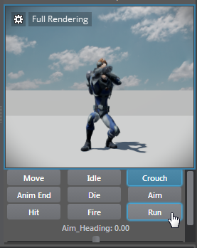

The Animation Preview panel updates to reflect your selections. As you add animation clips in the following steps, you can preview them accurately there.

The event is also added to the preview panel (seen after you save the animation controller), where you can select it to view the effect on your character.

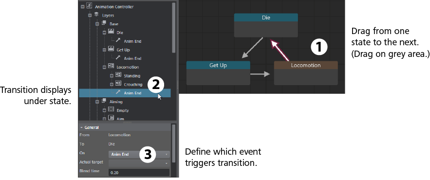

In the node graph area, drag from one state to the next (dragging on a grey part of the node).
This adds a transition that displays under the state.
In the transition settings (on the properties panel), under the Conditions category select an event from the On drop-down list .
The transition settings now read: From State: clipX To State: clipY On: event.
