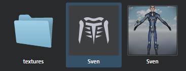

Click Import, then navigate to select the character mesh FBX file. See also Import an FBX file.
In the Import FBX options, enable Animation and select New or update skeleton for the Skeleton, then enter a name for this new character skeleton.
This creates a 3ds Max Interactive skeleton for the character mesh that lets you apply animation clips later on.
(See Import animation clips.)

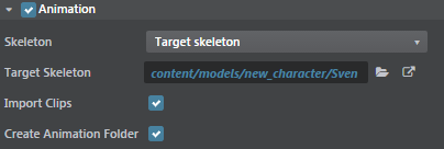

In the Import FBX options, turn off Unit Mesh, then set the following:
Select Target skeleton as the Skeleton, and then select the skeleton of the character you created earlier.
Example: content/models/new_character/Sven
Enable all options in the Animation section, including Create Animation Folder.

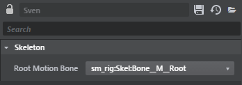

In the Asset Browser, select the character's skeleton.
In the Property Editor, select a bone from the Root Motion Bone drop-down list. This is the bone where root motion is extracted for this character.
Save the skeleton unit in the Asset Browser. (Right-click the skeleton thumbnail, and select Save.)

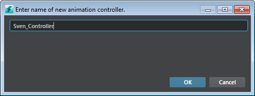

In the Asset Browser, right-click the character skeleton unit and select Create Anim Controller.
Enter a name for the Anim Controller when prompted and click Ok.

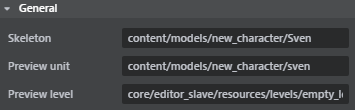

Set up the preview environment in the Anim Controller Editor as follows:
Select Animation Controller in the tree view.

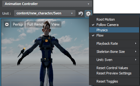

In the options below the Animation preview pane, use the drop-down lists to select the skeleton, unit, and level you want to see in the preview.
For example, if you find that your character's physics cause them to fall through the floor, you can disable Physics in the preview.

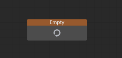

By default, one empty layer displays in the node graph area.

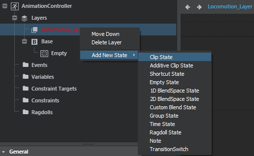

Select Layers in the tree view, right-click and select Add Layer.
Enter a layer name below the preview pane, for example "Locomotion_Layer", then click Add.

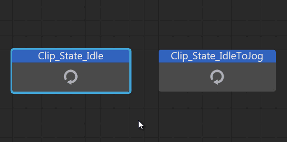

Add a state to the new layer (right-click and select Add New State > Clip State).
In the properties panel, click the Add clip field under Animations, then select from your list of imported animation clips.
The first state clip starts to playback in the timeline, and in the preview panel.
Now you'll want to add events to trigger each state.
In the tree view, right-click Events and select Add New AnimEvent, then rename the event in the properties panel.
Example: move
Add a transition that is triggered by the move event:
In the preview panel, drag from the 'idle' state to the 'walk' state.
In the properties panel, under Conditions, set the On property to Move. (The anim event you created earlier.)

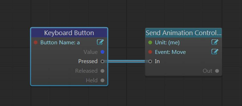

In the Unit Flow graph, add a node to drive the event you added.
Save the unit (File > Save), then close the Unit Editor.
Drag the character unit from the Asset Browser into the current level.
Press Play in the Level Viewport Toolbar.
Now when you press 'a', the unit flow triggers the move event, and your character walks forward.
