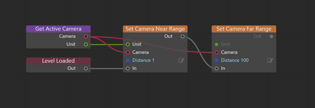

By default, the interactive engine sets up clipping planes with expected distances for general real world scale. This may not be ideal for your project and sometimes you'll need to adjust your clipping planes accordingly.
To adjust clipping planes in the viewport:
To adjust clipping planes:
In Level Flow, access the camera with the Get Active Camera node, then use the Set Camera Near Range and Set Camera Far Range nodes to set distances as needed.

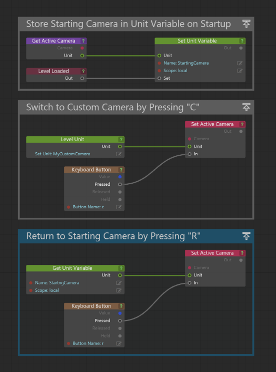

You can control camera movement with many different methods.
The default “fly mode” cameras found in some of the default Template projects can be useful to switch to and from. Unfortunately, because they are not level units they can be tricky to get at. You can use this simple bit of Flow code to store those cameras for use later on. Use this trick to store any camera so that you can return to it.
