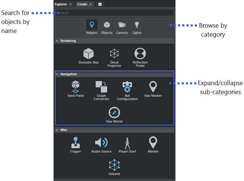

Lets you create standard level objects that can be placed and modified in the level. See also Create level objects.
Search for the object name, or browse by category of object.
The Helpers tab in the Create panel lets you create components from the following categories:
Occluder Box

Trigger
You can think of triggers as switches. When the switch is activated (something enters or exits the trigger volume) an action can occur. You can access triggers using flow nodes or Lua scripts. See Create a trigger.
Audio Source
Creates an audio source unit. Place this unit in the level to play an event whenever the audio listener enters the Source shape area.
See also About audio sources and Wwise Workflow Tutorial.
Player Start
The location and position of the Player Start object defines the starting position of the character when you run or deploy your project. If multiple Player Start units are added to a level, the start position is randomly selected.
Marker
Markers are used for locating a position in your level so you can make actions happen at that location. For example, you can spawn a unit at a given Marker. See Create markers.
Volume
Primitives are simple shapes, 1-metre square by default, that you can use to prototype scenes quickly. See Create primitives.
Terrain
Use terrain tool to create and model a landscape in the level. See Create terrain.
Empty Entity
An empty entity is an entity with no components and inherited assets. See Create a new entity asset.
Prototype
Prototypes are simple cuboids with adjustable size and shape properties. Use them to develop geometry rapidly and rough in the elements of your scene before you have final artwork. They are also useful for creating invisible physics actors. See Create prototypes.
Spline
Splines are user-generated 3D curved paths, commonly used for constricting motion. See Create splines.
Lets you create a standard camera. See also Cameras.
Lets you create a physical light entity. See also Physically Based Lighting and Create a physical light.
Lets you create a standard light. See also Create a light source.
