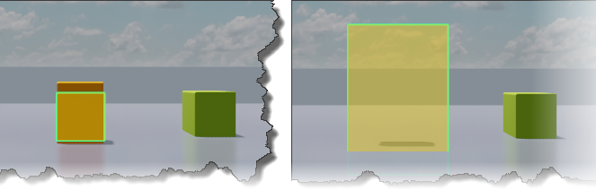

In the level viewport, place the occluder box in front of the unit to cull so that one side of the occluder box covers the mesh of the unit.
The occluder box is a transparent yellow box and is invisible when you run the project.
Adjust the scale of the occluder box to fully cover the unit. As you adjust the box to cover the bounds of the unit, the unit is culled and disappears from the viewport. Along with the main occluded unit, other objects get culled if they are within the bounds of the occluder box.
On test playing the level, the culled units are invisible if they are within the range of the camera.
