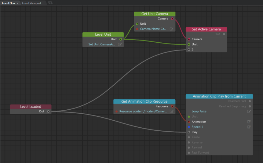

Open the Level Flow Editor and create Flow nodes to set the camera as the active camera and set the animation clip to start playing back.
Test the level. (Click the green Play button.)
This launches your level (in the Test Level window) so that you're looking through the new camera as it plays back its animation.
