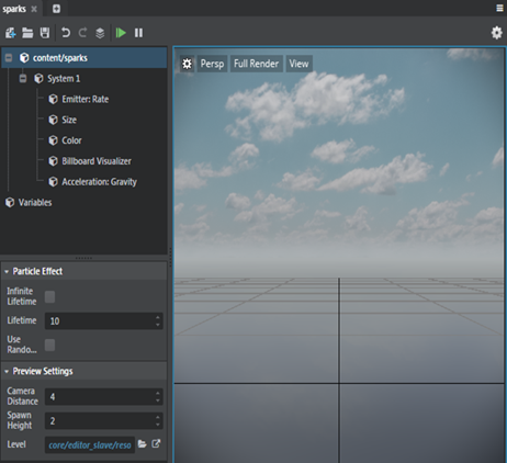

The main way you'll work with particles is by modifying the properties of the particle system. Particle systems are simply a group of commands that guide each of your particles from their birth to their death.
The default particle system is called System 1, and you can add and remove controllers to any system to customize the particle effect. Each particle effect can have multiple systems, and each system can have multiple controllers.
Select a particle effect asset in the Asset Browser and double-click to open it in the Particle Editor. You can also open a particle effect asset using the Open icon

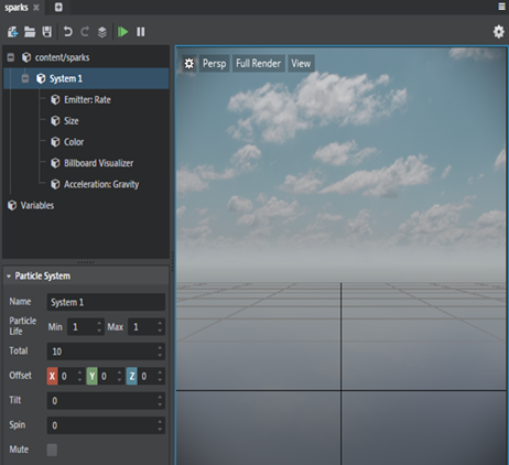

The particle system properties are displayed in the Particle Editor.
Select System 1.
Selecting System 1 shows you the general, overall properties of this particle system.
In the default system properties, you can edit the system name, set the particle life span (min/max values) in time in seconds, or control the spawn position with the Offset, Tilt, and Spin properties.
See the components of System 1.
By default, this system contains Emitter:Rate, Size, Color, Velocity:Box and Billboard Visualizer components. The Billboard Visualizer uses the custom particle material created for the particle effect. Replace this material with a material graph (containing a Particle Base shader node) of your choice.
Note: If you delete the Billboard Visualizer component, the particle effect won’t display. You can use a non-rendering particle system to act as a trail spawner for other particle systems.
Select each component to view the properties available for editing.
