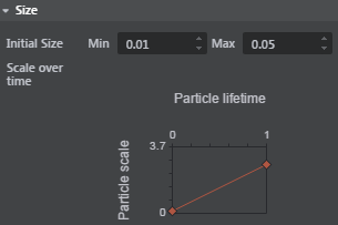

Select the Size component, and for the Initial Size property, change the Min value to 0.01, and the Max value to 0.05.
Adjust the particle scale over life time graph to go from 0 to 1.
Tip: Increase the width of the Property Editor to see greater detail of the property graph.

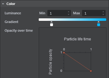

Select the Color component.
Click the small white square below Color Gradient, then choose a light blue color from the Color Picker and click Ok.
Click to the left of the now blue square to add another color to the gradient bar, and keep this one white.
Slide the light blue square to the right.
Tip: To remove a color, right-click the square.
Lastly, we'll make the sparks fade out over time.
Adjust the Particle Opacity graph by dragging the end-time point down to 0.

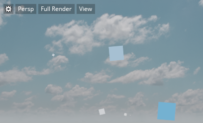

The particles look similar to the following in the Asset Preview:

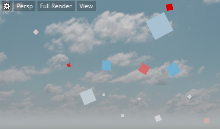

Change the color of the System 2 from light blue to red.
The particles now look similar to the following in the viewport:
