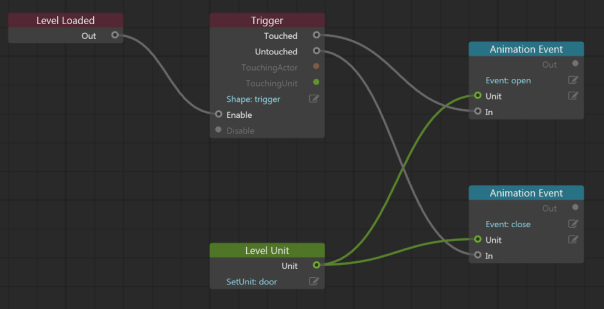

Flow is the visual programming system built in to 3ds Max Interactive. With node-based Flow tools, you can author gameplay logic to determine all the interactions possible in the engine. Using Flow, you can set up mission scripts, trigger effects, or define how units react to events in their surroundings.
If you're not comfortable with Lua scripting or C++ programming, Flow packages some of the most powerful parts of those languages into this accessible, visual form. Using the Level Flow Editor, you can visually wire objects and events together to author the experience you want. Think of the level flow as if you're creating a story to describe the behaviors and situations possible. For example, you might create a flow that explains 'when a character touches this trigger, the gate object will open and close'.
