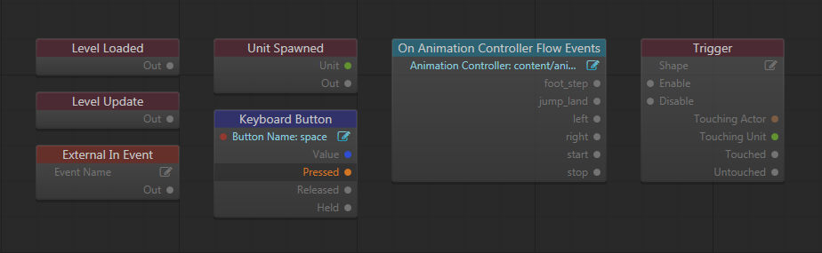

Certain kinds of Flow nodes emit events in response to triggers that happen in the engine or elsewhere in your gameplay logic. You can recognize these nodes because they fire an output event, even though they typically have no input events.
For example, some commonly used event emitter nodes include:
Note that the Event > Trigger node does have an input event that turns it on or off. While enabled, it is capable of emitting new events that kick off new graph evaluations; while disabled, it emits no events.

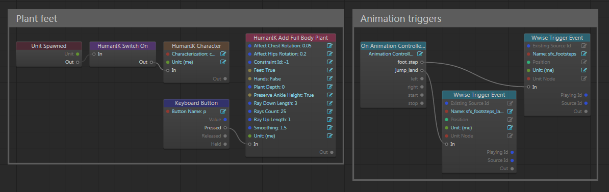

Note that a Flow graph often has multiple separate chains that get evaluated at different times, in response to different triggers. Each chain is independent of the others.
For example, in this unit flow there are three separate event chains that are evaluated at different times. When the unit is spawned, the HumanIK system is initialized and activated. Pressing a specific button activates HumanIK foot planting. Finally, in the group on the right, each time the character's animation controller detects a footstep or jump marker in the animations it triggers Wwise to play a sound.

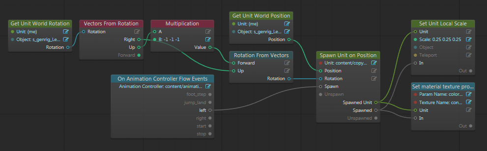

Some nodes, called query nodes, break Rule 2. These nodes produce output data values that other nodes can query for use in their calculations. Query nodes are evaluated only when another downstream node that uses one or more of the query node's output values is evaluated.
You can think of query nodes as reversing the typical direction of evaluation. Instead of a query node being triggered by an upstream node emitting an event, it is triggered by a downstream node that wants to use one of its outputs. When multiple query nodes are chained together, evaluation reaches back to the first one in the chain and passes the values forward again.
You can recognize query nodes because they have only data connectors, with no input or output events at all. Typically, they are used to retrieve up-to-date data from variables or units, to come up with values for math or Boolean operations, or to convert input data values between different types.
Here is an example of a unit flow graph that uses both event connections and query nodes. The initial trigger is an animation controller event that indicates when the left foot hits the ground. That causes a new unit to spawn, to represent a footprint. In its calculations, the Unit > Spawn Unit on Position node needs to know the position and orientation for the new unit, so it reaches back through a chain of query nodes to get those values.
