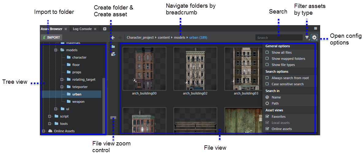

The Asset Browser is the main way to browse and import assets in your project. It includes two main view panels, the folder or tree view, and the file view. Both areas include several controls that let you browse or search for assets efficiently.

The Tree view displays all folders in your project. Select a folder to display its contents in the File view area.
You can use the Import button directly above the Tree view to import assets directly to a selected folder.
The File view displays all assets and sub-folders in a selected folder.
When you select an asset in the file view area, a preview displays in the Asset Preview window.
Use the vertical slider between the tree view and file view to control how large or small the file icons in the file view display. At maximum zoom, the files display in a list. At minimum zoom, the file icons display full thumbnails, which are generated when the asset is imported or updated.
Tip: Press Ctrl + mouse wheel over the file view to change the zoom level.
The file view indicates read-only folders and resources using a lock icon:
The Favorites lists the assets and folders you bookmark as a favorite
. To add a frequently used asset or folder as a favorite, check the favorite icon
beside the asset/folder or right-click and select Add to Favorites. You can also drag and drop assets and folders to the Favorites.
To remove the favorite bookmark, select the asset or folder, and uncheck the Favorites icon or right-click and select Remove from Favorites. You can also hide the Favorites from the Asset view by unchecking Favorites in the configuration option
Use the Search field above the file view to search for resource names within the currently selected folder and its sub-folders.
Tip: Press Ctrl + F to focus the Search field.
Click the config icon
to set search options.
You can set the file view to show only selected resource types. Click the Filter icon
to open a list of resource types. Toggle each filter on and off to further narrow your search results to a specific asset type. (For example, turn off Flow nodes if you are primarily working with geometry or animation clips.)
You can also use the configuration options
to control what resources are shown in the tree view and the file view:

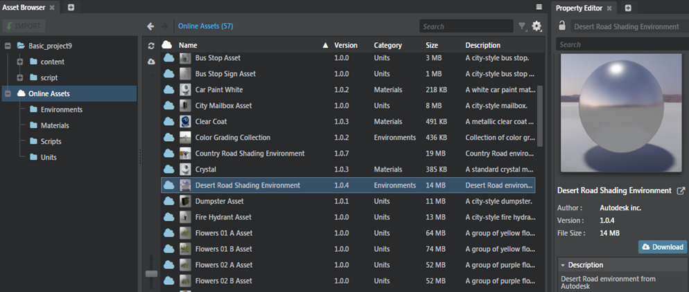

Use the Online Assets in the Tree view to browse, search and find online assets.
To download an online asset, do any of the following:
.To cancel downloading of the asset, click the yellow icon
To search for an online asset, use the Search field. The number of matching assets are listed next to the Online Assets.
To hide Online Assets from the Asset view, uncheck Online Assets in the configuration option
To view or locate a downloaded asset in your project, select an installed asset (indicated with a green checkmark) and either click
or right-click and select Locate in Project.
The online assets are not listed in the Asset Browser if the Online Assets server is disconnected from the cloud services.
