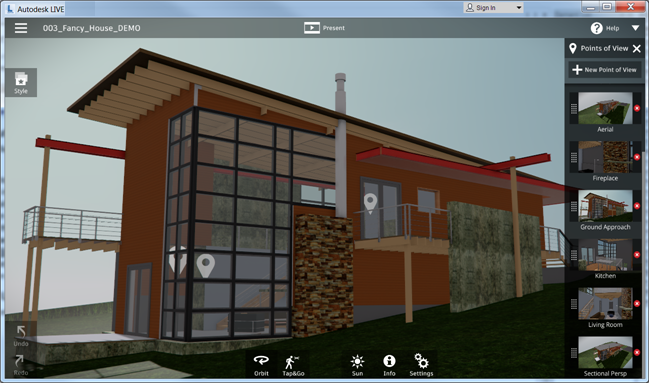

The Live template is an interactive project that offers all the runtime features of Autodesk Live, but without any content. Start a project from this template, bring in your own custom models and materials, and you can deploy your own customized Live experience.
