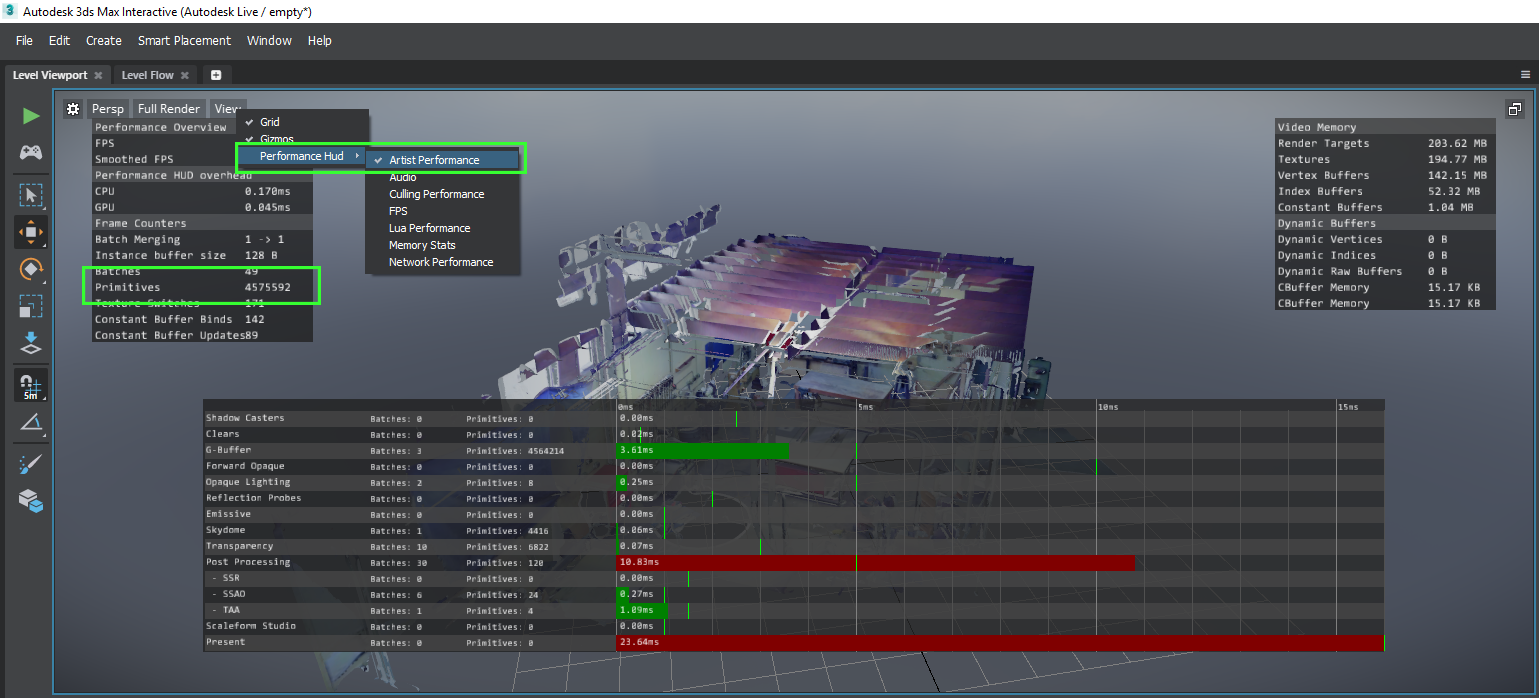

One thing to keep in mind is the number of triangles in your mesh. If you find that your scene is lagging, try to reduce the complexity of the mesh in 3ds Max or another content creation tool.
Tip: To view the triangle count in 3ds Max Interactive, click View > Performance Hud > Artist Performance button in the Level Viewport:

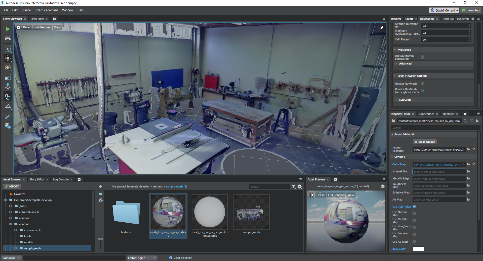

Place the data
You can drag and drop your point cloud unit from the Asset Browser into the Level Viewport to place it in your level, then move/rotate/scale it as you would any other unit.
If you're using your point cloud with the Live template, you will also want to regenerate the navigation mesh and add a physics actor to your mesh. For more information, see Set up the Live template.
The mesh shown above has about four million triangles, and its normal map has been removed. There is a single light in the scene, but its shadow casting has been disabled in order to help with peformance. This scene runs at about 100 frames per second, at a resolution of 1920x1080p, with an NVIDIA GTX 1060 GPU. Perfect for VR!
