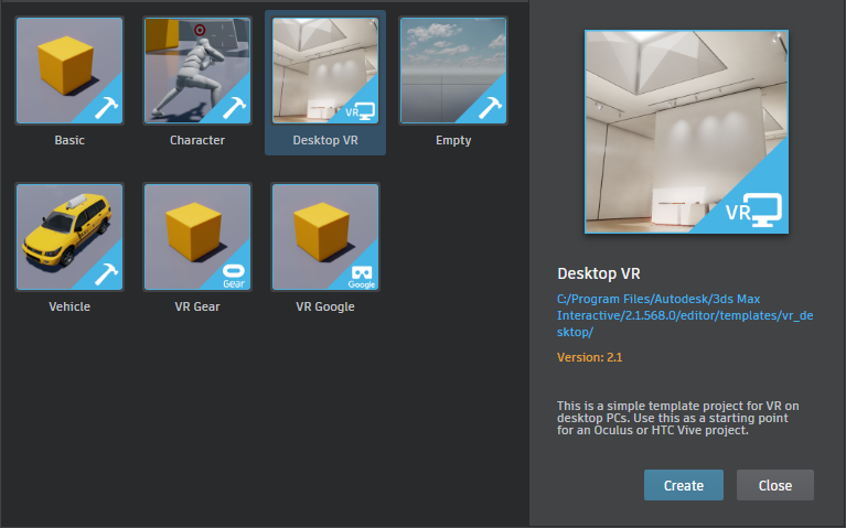

The 3ds Max Interactive editor ships with a few sample projects to help you get started with VR, including templates for HTC Vive, Oculus Rift and mobile VR devices. These projects contain some extra content specific to each VR device -- like Lua scripts, Flow nodes, and controller models -- and are pre-set with appropriate project settings.
The best way to start a new VR project is to start from one of these VR templates, shown in the Templates tab of the Project Manager, instead of trying to alter an existing project to make it work in VR.
