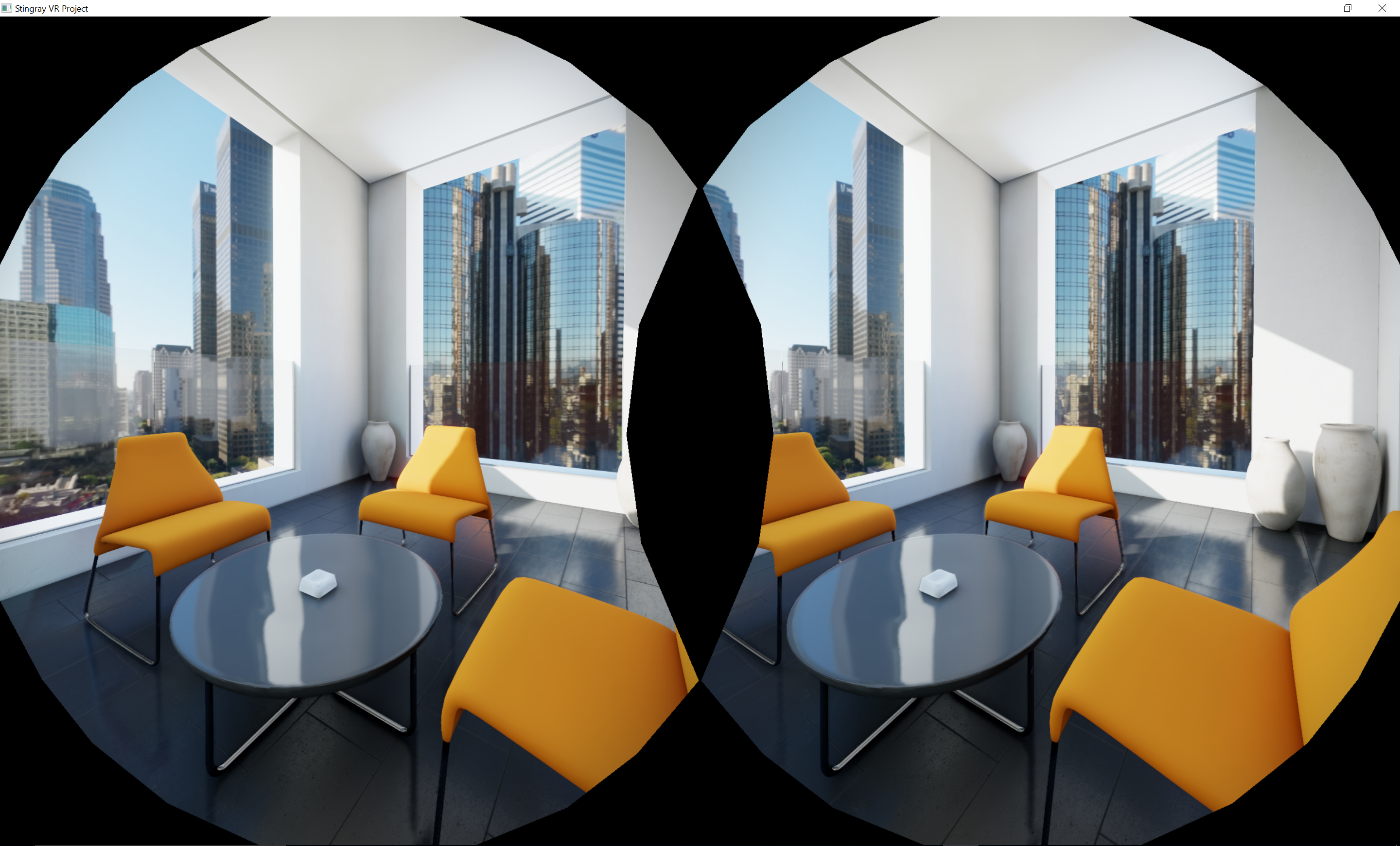

The Hidden Area Mask uses a mesh to cull out pixels that are not visible in the final image as seen through an HMD (Head Mounted Display). In other words, this is the first mesh to be drawn in the depth stencil buffer when in VR mode. This ensures post processing is only applied on visible pixels. For example, in the following image, the black pixels represent the hidden areas on the HMD.
Note: The Hidden Area Mask is provided through the HMD software development kit and is only available for the HTC Vive.
