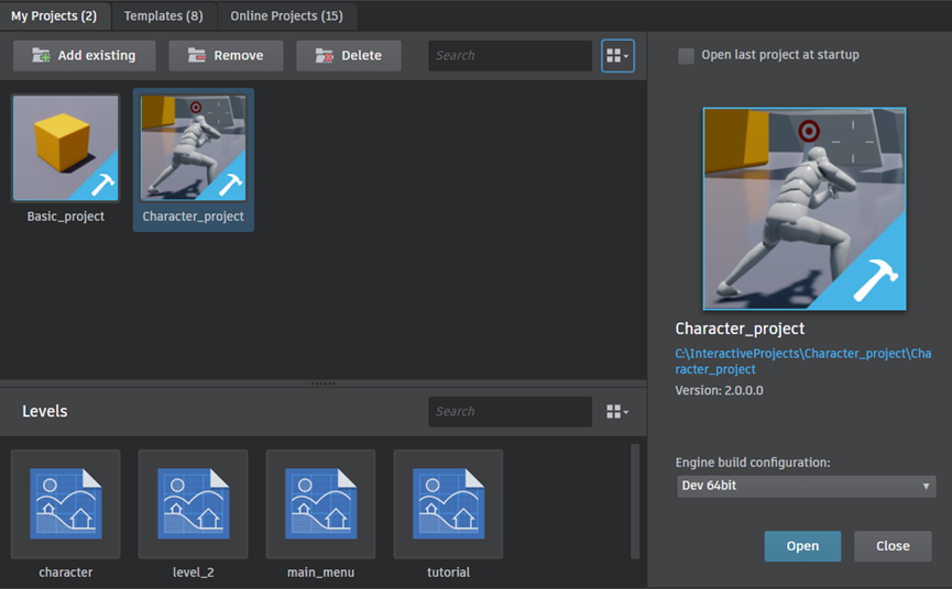

To open an existing project for the first time:
  1. Open the Project Manager. Do this either by launching the editor, or by selecting File > Project Manager from the main menu if you already have the editor running.
  2. Open the My Projects tab.
  3. Click Add Existing. In the dialog that appears, select the file type depending on the project you want to add and browse to the location of the project on your local computer. Select the .stingray_project or the .zip file for interactive projects and the .lvsc file for Live scenes and click Open.
    This adds the selected project to the Projects area of the My Projects tab.
