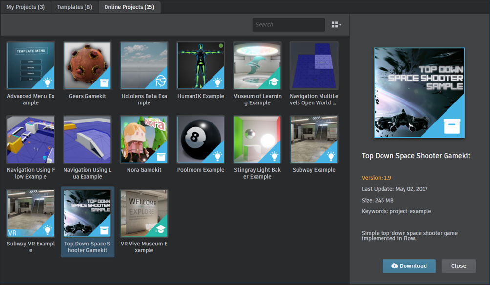

Sample projects that illustrate the potential of specific elements of 3ds Max Interactive and example projects that show more complex usage of components like Scaleform Studio, HumanIK and Gameware Navigation are available as online examples. Download these projects using the Online Projects tab in the Project Manager.

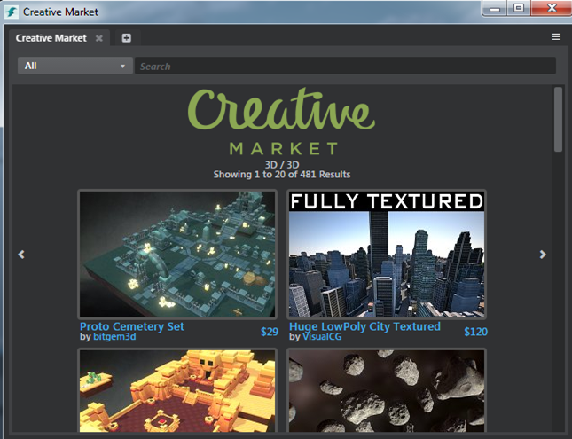

Visit the Creative Market store to purchase a variety of 3D assets created by the community for use in your projects, or to sell your own creations.
You can browse these assets inside the interactive editor, using the Creative Market panel (Window > Creative Market).
